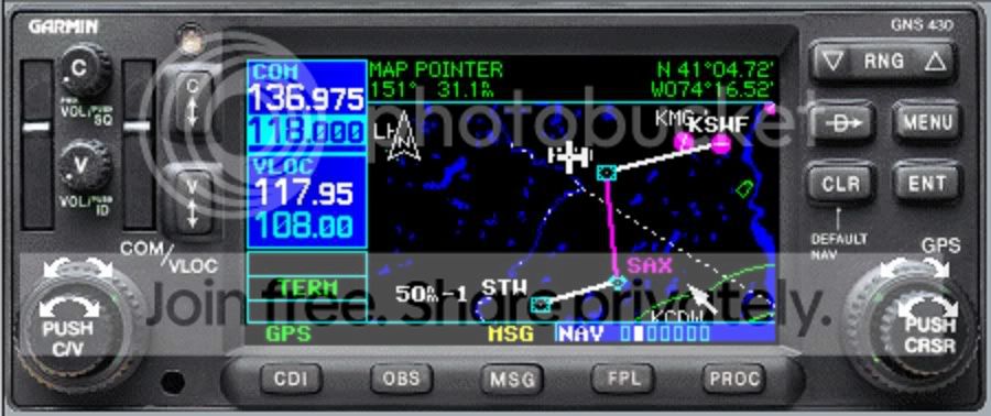

So you take off and ATC gives you vectors for quite a while, all the way past the HUO VOR, placing you just northwest of it.  No worries if you intended to catch the leg between HUO and SAX - the GPS has already cycled to that leg and the airplane is where it appears here:
 But wait!  ATC just cleared you to fly a heading of 180 to intercept the SAX - STW leg and it isn't the active one.  If you pass close enough to SAX for the Garmin to interpret that as "passing" it, then it will cycle in time, but how can you know it will?  With this tip, you'll be able to activate that leg right away and alleviate the worry that you won't be able to navigate on it.  For an added bonus, tell your autopilot to capture the leg by pressing and holding HDG while pressing NAV twice for GPSS capture.  If you don't know about this autopilot trick then either ask your local CSI or just ask me and I'll talk about how it's done.
